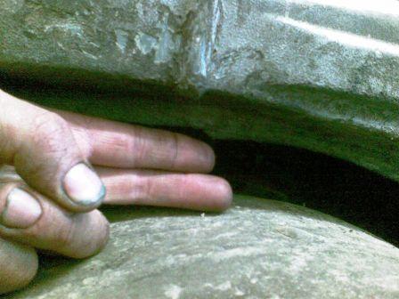

        i took a pick of the clearance between the top of the tyre and bottom of the inner wing, hmmm its getting tight there i definatly cant lower the car and more!

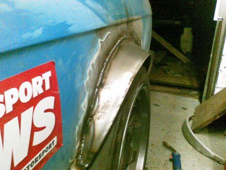

        i also decided i didnt like my new rear arch, so i cut it off!
        welded the inner and outer skins back togther and bent/ folded/hammer a new arch from some sheet steel
          Nice work, will look good with a bit of paint on
          Are you running that size all round now then. I assume the front arches are easier to mod than the rears Or are you still limiting the lock on the rack??

            i want to run the same size all the way round as it makes life much simpler and cuts down on the number of wheels i have to cart around which really is getting an issue because the 10x18s take up so much space.
            yes front arches are easier to mod than rears but i stil need to limit the lock by quite a bit because they foul on the vertical part of the inner wing with and real amount of steering lock

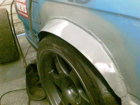

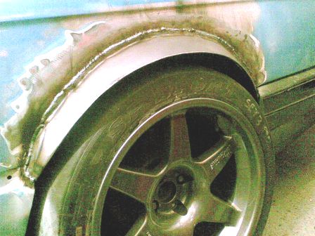

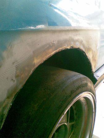

                i got a couple of hours in the garage over the last two days and and cut the old o/s/r arch away, welded the skins back together and fabricated a new wider wheel arch
                18's here we come
                  Looking good Graham, will it run the same ride height with those wheels then?
                  Guess you'd better order up the other pair of wheels now
                    • 25249
                    wheels are already on order,
                    the bigger rolling radius is going to lift the rideheight about 1/2 inch, but in going to have to live with that, as there just isnt sufficent clearance between the underside of the innerwing reinforcements to lower it any more, and in any case winding the suspension down will compromise the geometry

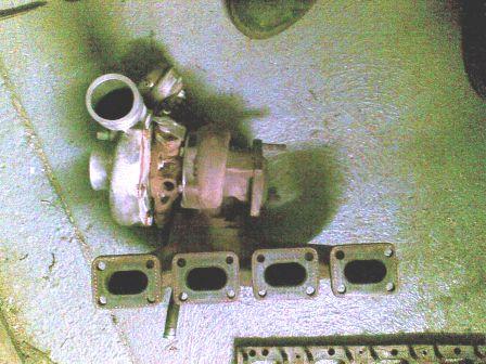

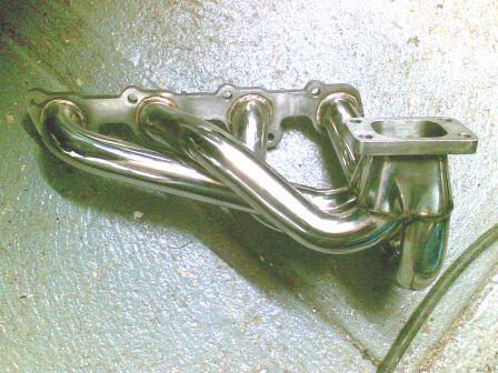

                            a little progress from yesterday, drained the coolant removed a few hoses, teh turbo and the manifold adapter plates
                            1 turbo on a wont stay tight manifold,

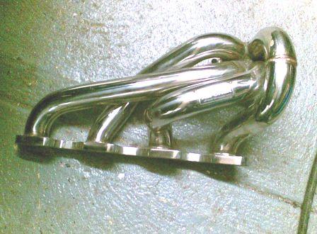

                            i also offered this up to try for size, an ebay special, its for a volvo, it nearly goes, unfortunatly its just a bit to bulky in one spot so i wont bother with it, although i have an idea it would easily adapt to suit a pinto though, now i wonder who also has one of them???????????
