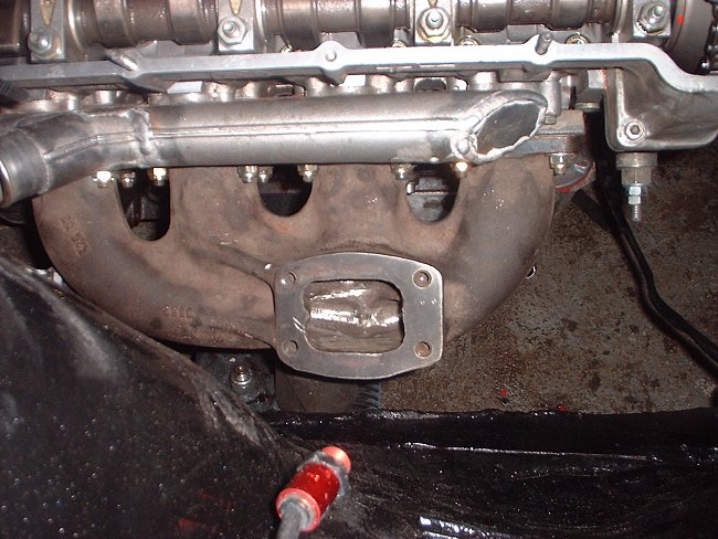

          had to make a spacer so the oil drain pipe would fit the turbo and clear the manifold, still got to remake the actuator bracket, as the turbo orientation is now different, and it now clear that i wont be able to take the short route with the turbo down pipe, it just never going to fit past the steering, suspension and gearbox, so i'm going to have to follow last year up and over route going round the back the cylinderhead and out the n/s of the engine bay.
          although before i get that far i've got to figure out a way to tighten one of the turbo to manifold mounting bolts, the one by the intake compressor nearerst to engine is impossible to get to

            #140
            Can you not split the turbo and then get to it..or will that leave the the turbo's bolts in the same s**t.
            (you can tell i dont know about turbo's can you split them?)
              #141
              looking at it agian whilst remaking the actuator bracket i think if i get some studs and "k" nuts which have small size hex and remove the oil drain i will just about be able to get in there

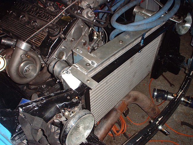

                #142
                not too much progress, i've connected most of the wiring loom, made a new bracket for the actuator and fitted the rad and intercooler as well as ordering the bends to make the new down pipe

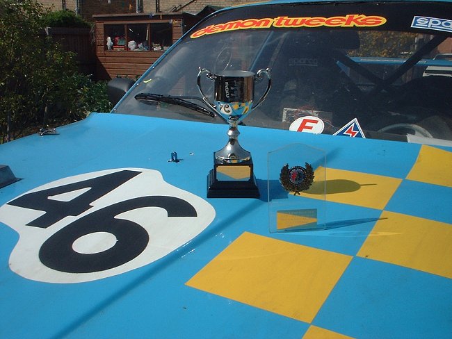

                          cheers david,
                          was a great day, finished 2nd and then 1st in class which equated to 5th, and 4th Overall, oh i do like beating class A cars.......................... bring yours on david.............
                          bigger front wheels and tyres have changed the cars balence its much more oversteery now and most corners a i was using opp lock to catch the rear end although mostly still with my foot in., so maybe the loss of power wasnt a bad thing.
                          the big power loss really does notice in a straight line so i was pleasently suprised to find i could out drag john cross's V8 eurocar up hill!

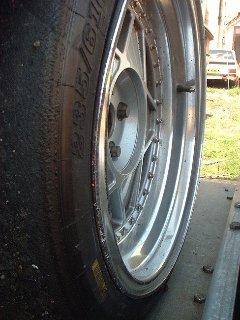

                          i had a titantic battle with john for most of the second race, eventually he got the better of me into devils elbow, which is my cars weakest corner as i have very poor traction out of it, but caught him going up the hill, to turn in earlier and cut inside him at north turn, and get a good run on him down hairy hill, and get the inside line at paddock, unfortunatly i just couldnt hold as tighter line as i needed and we did a bit of wheel to wheel rubbing and i didnt quite make it past him so i now have some bodywork to do and need a new outer rim for the rear wheel.
                          it would of been one hell of a move if it had stuck, but i'm pleased i had the confidence in the car to try it, rather than just let him go as i could of easily done as teh class win was in the bag, but hell we were racing.
                          some battle damage pics to follow soon when my cameras batteries are charged

                              #149
                              pics
