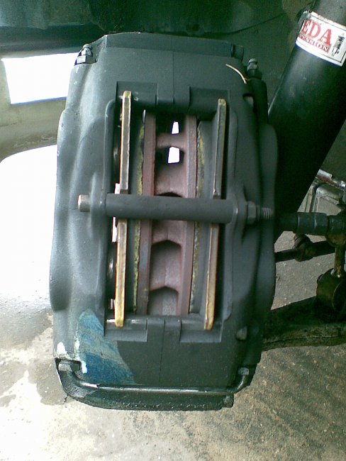

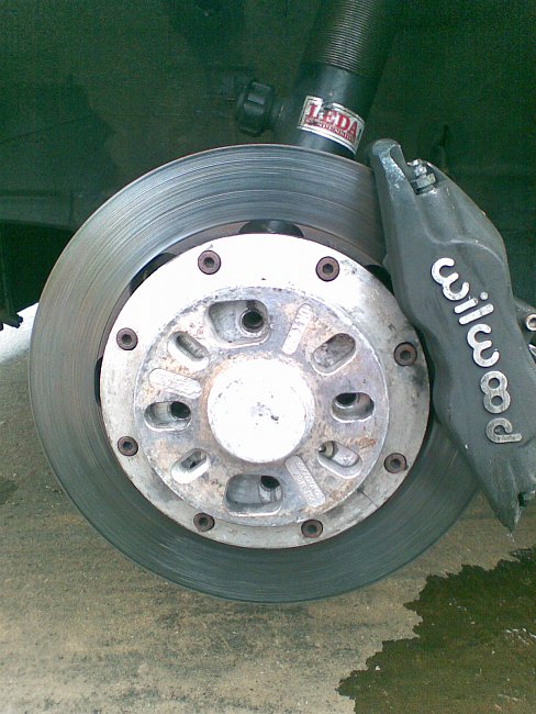

            i've never posted and brake pics, but i took a couple at snett,
            front discs are 300mm and 24mm thick on alloy bells, calipers are willwood superlites, all from rally design, as individule components, i had to make my own mounting brackets and machine the bells,
            snett was starting to stretch there capabilities but they coped, the reason they are not bigger is that was the largest i could get inside 15 inch wheels, although i now use 17's i have to run 15's in the wet, unless someone wants to sponsor me via a second set of 17's and a new set of wets
