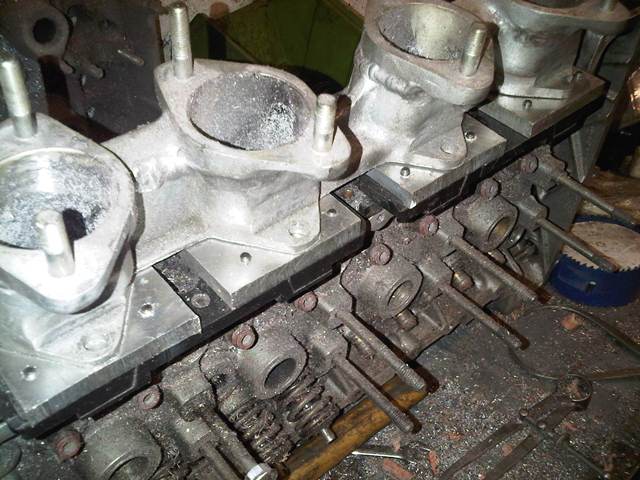

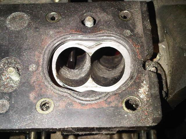

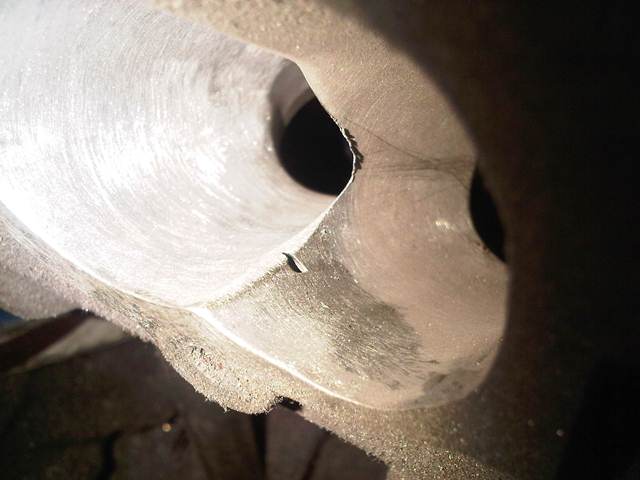

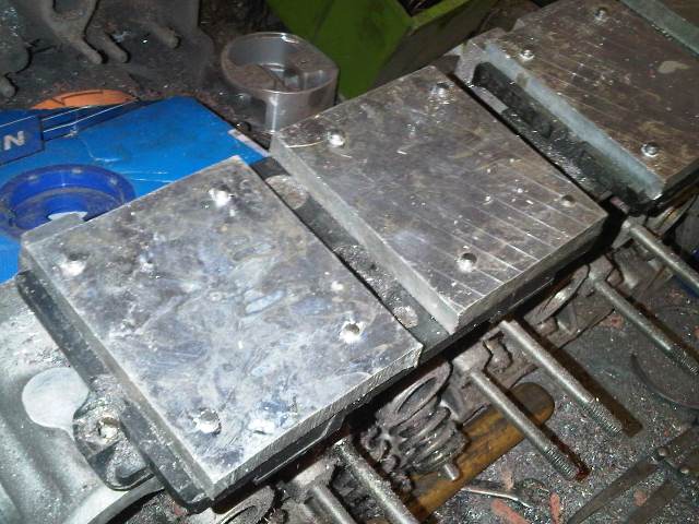

                    another 5hours of grinding and im almost there the portings done, i just need to do some detailed work on the short side, boy am i sick of grinding aluminium, so much so im really looking forward to grinding a pinto head LOL! as per usual on teh last port i broke through, fortunatly this time only into the end on a manifold stud hole so its of no consiquence.
                    i've also made a start on the inlet adapter plate transferring the manifold and head shapes to a polycarb off cut,to use as a template, i can feel plenty more hours grinding coming on!!!

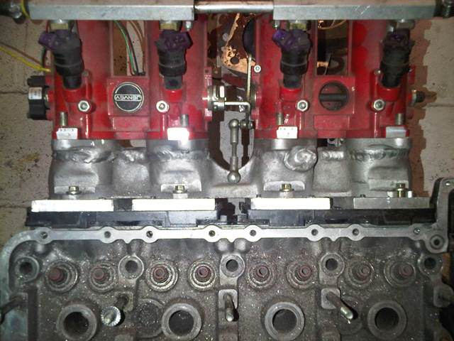

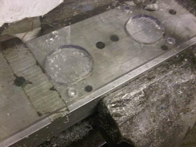

                            a bit more progress, having started to make an adaptor plate, ive changed my mind, after starting it i found the missing OE inlet manifold rubber mounting thingy that i've spent 6 months looking for, so i abandoned the thick adaptor not really wanting to hang a couple of kgs of alloy on the side of the head anyway, plus with limited space it was really difficult trying to get all the drillings in the right place and leave space to get a gas tight seal
                            heres one of the OE inlet throttle body mounts which has been opened out to match the ported head on an unported head
                            so instead made 4 small adaptors to go on the manifold rubbers
                            here we are m10 manifold and jenveys on the s14, still got to put the ports in the adapters but due to the m10 having taller but narrower ports i wil probably end up filling in the bottom of the manifold with some jb weld, otherwise im going to end up with a nasty sharp turn in manifolding where it meets the port

                                Nice work Graham, that picture of the port adapter versus the standard port really shows how much material you had to remove!
