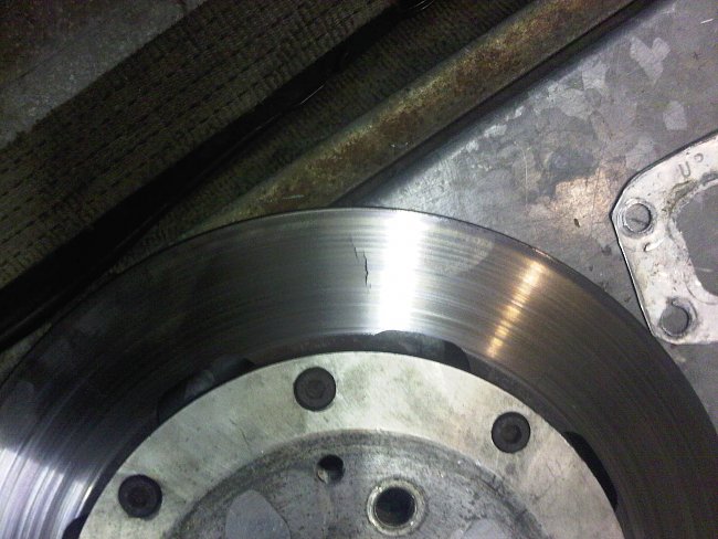

                              i didnt fancy doing the next round at snet with rapidly growing cracks in the discs, although deep and wide enough to get your thumb nail in suprisngly they didnt go all the way through!

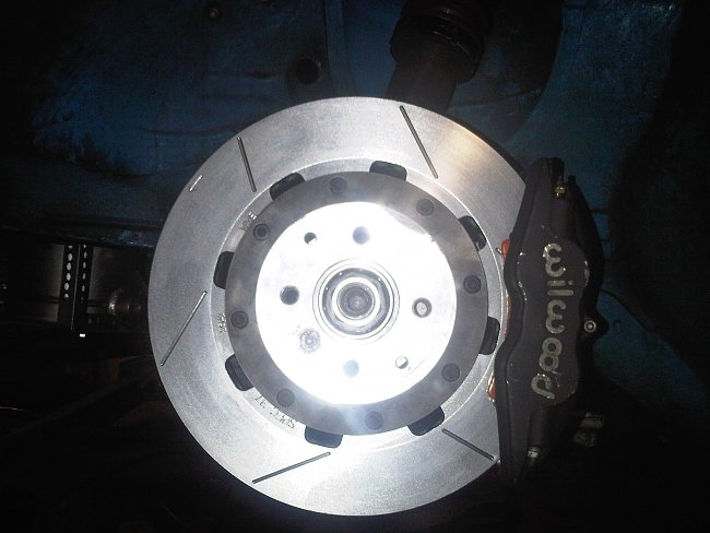

                              i opted to upgrade from the current 298mm which were origonally chosen because thats all i could get in my old 15" wheels to 323mm, TBH bigger discs add little to the braking power, because although ive gone up 25mm dia, its only giving the caliper half that in increased leverage, they should run cooler though which is a major plus point

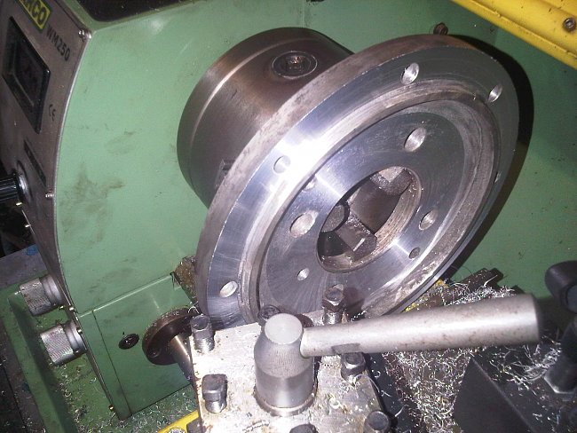

                              going bigger still would of ment buying new bells as it was i put them in the lathe, faced off teh outside edge then turned them round and trued up the hub and disc mount faces to ensure everything ran true

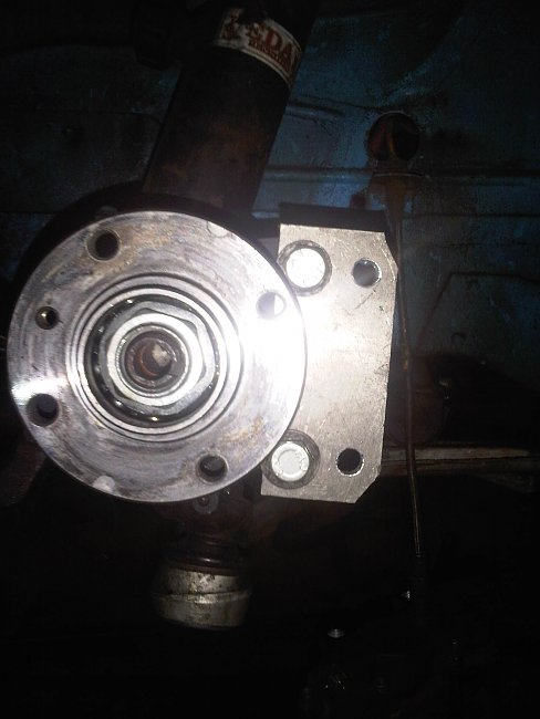

                              i had to make new caliper mounts, not to hard thou the calipers and hubs both are 88mm centre to centre, so it was simply a case of marking and drilling 4 holes 88 and 29mm appart

                              new disc has a load more cooling viens, so hopefully they wont warp for a good while,

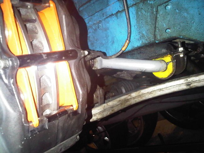

                              note the nice silver ARB, its a new one, after softening the springs the car seems to have better mid corner grip, but that hasnt helped turn in, so i looked at trying thicker ARB, eibach do a nice adjustable one, but thats only as part a front and rear bar kit , and supringly thin @22mm for the front, suprising because, high spec e30s come with 22mm, which is what i thought i had, only it wasnt when i measured it i found a 19mm bar on my car! in the end i bought a whiteline bar, much much cheaper and very thick at 24mm, so if it turns out to thick i'll make some sleeve to to make it adjustable, the only downside is a thicker ARB and bigger heavier discs have added yet more weight to the car
