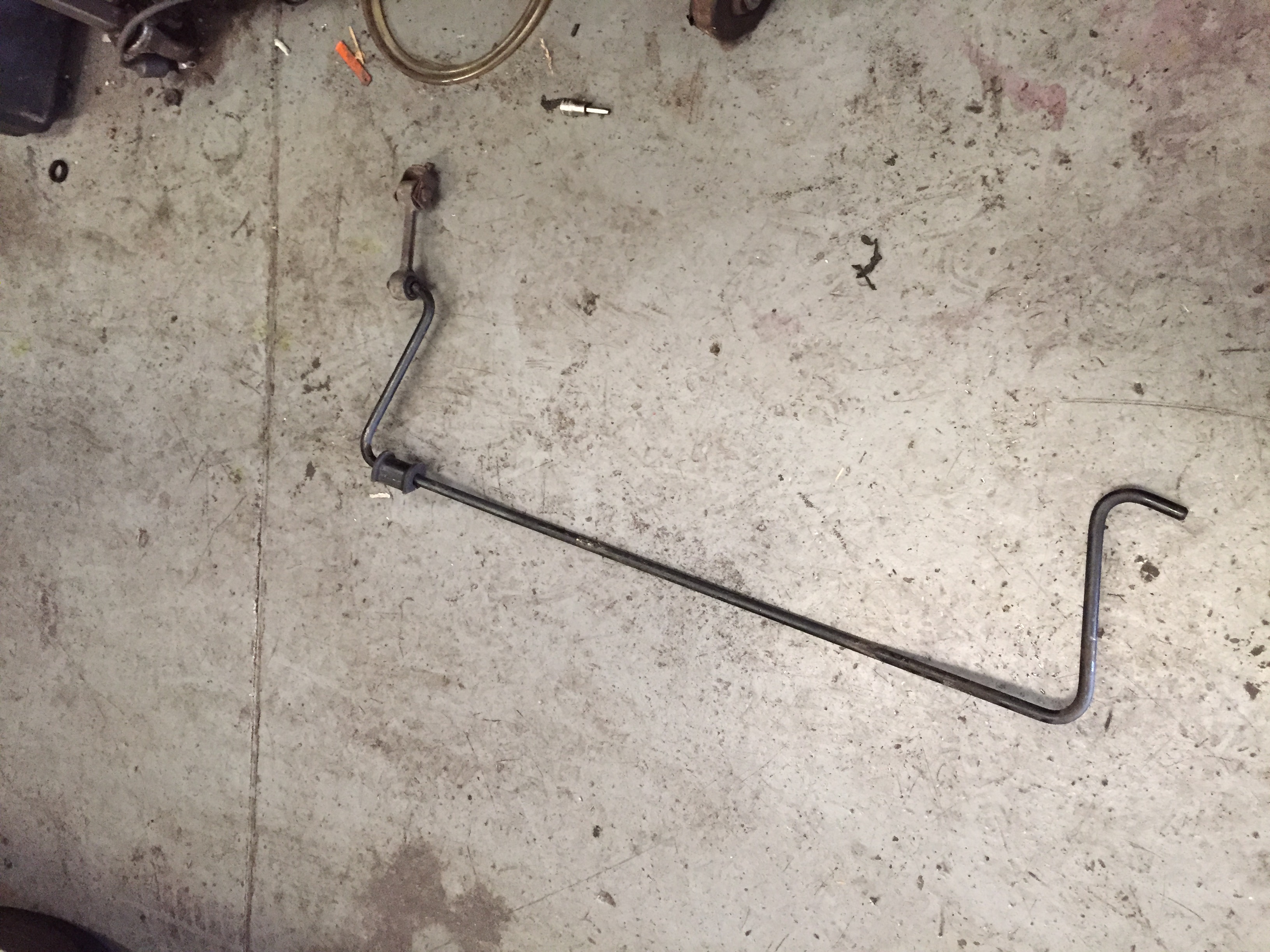

            i took the rear ARB off altogether, no point leaving it on the car with one end disconnected!

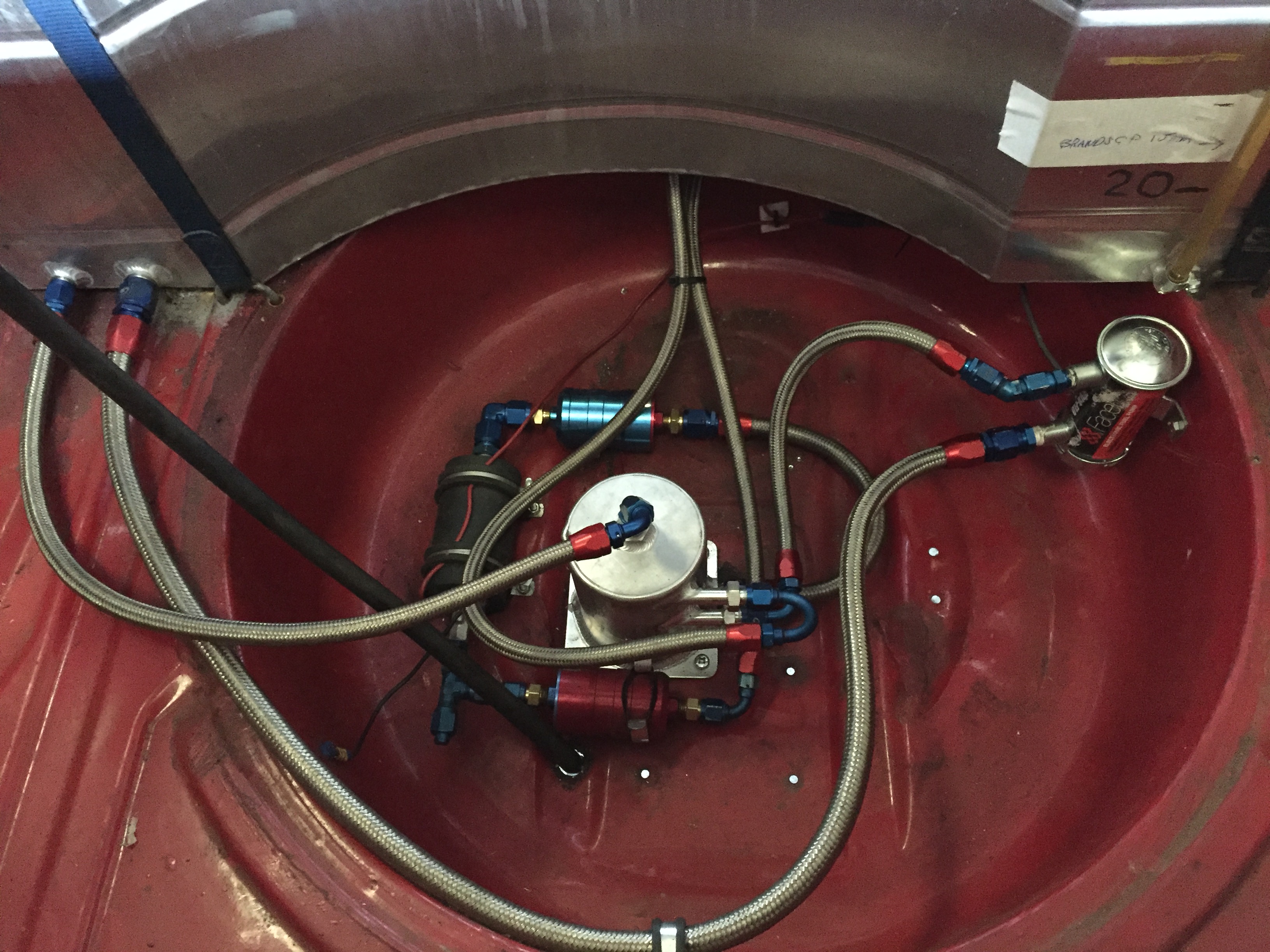

            im a bit annoyed with the fuel tank, o bought one with a built in swirl pot to avoid having to run twin pumps and a separate swirl pot, but brands proved its not upto the job, so ive added a standalone pot feed by a Facet red top. the install isn't the neatest, i did it using the minimum possible new fittings, and without cutting any existing fuel lines, not something you want to do, as you need a disc cutter, and thats not recommended when the fuel lines concerned have fuel in them! the new setup works well as gravity alone was enough to fill the facet and swirl pot. i had been pondering what to do to improve the cars turn in, i was unsure what to do until a spotted a picture online, it struck me the car had more body roll on the rear than front not surprising perhaps, considering i had disconnected the rear ARB, i thought about it and decided to increase the rear spring rate, my thinking was it might ease the load on the front end when cornering but keep the extra traction out the corners that i got from the ARB delete. at this point i didnt know the rear spring rate, turns out they were 600lb so i upped them to 700 (would give a wheel rate of around 350lb) finally i chucked it back on the scales it came in at 1031kg with me on board, so almost identical to the last time, but with about 15-20 litres more fuel on board, pleasingly front-rear bias had improved slightly to 55F/45R

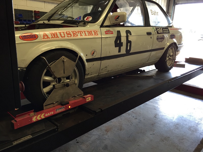

            finally i popped the tracking gauges on it, to see what if anything had happend to the geometry, the front was still were i had set it parallel, and the rear had slight toe in, id never checked the rear, but it had been modified to make rear toe adjustable so i was sure where it would be, slight toe in is way less than you normally get on a lowered E30 rear end.

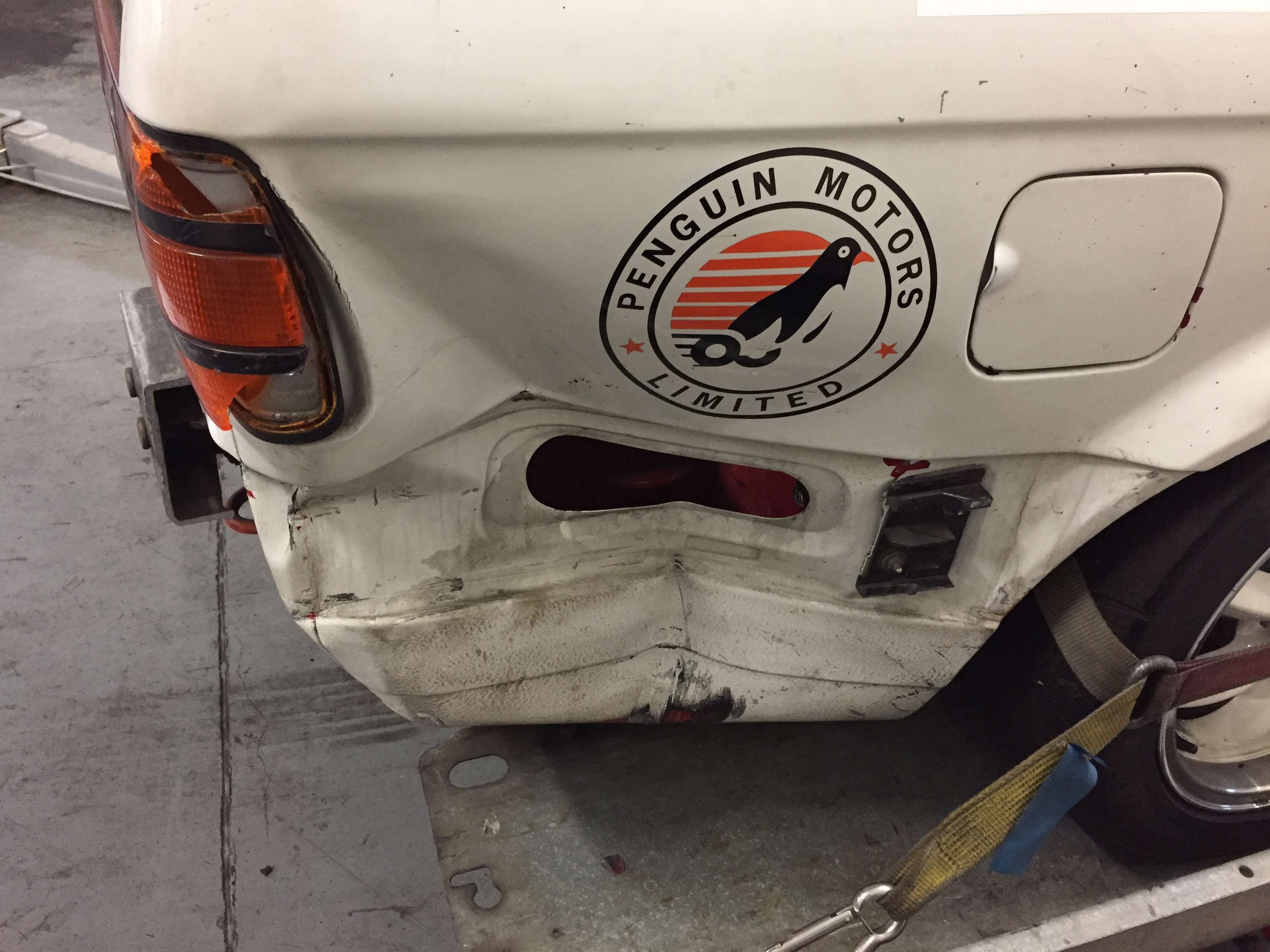

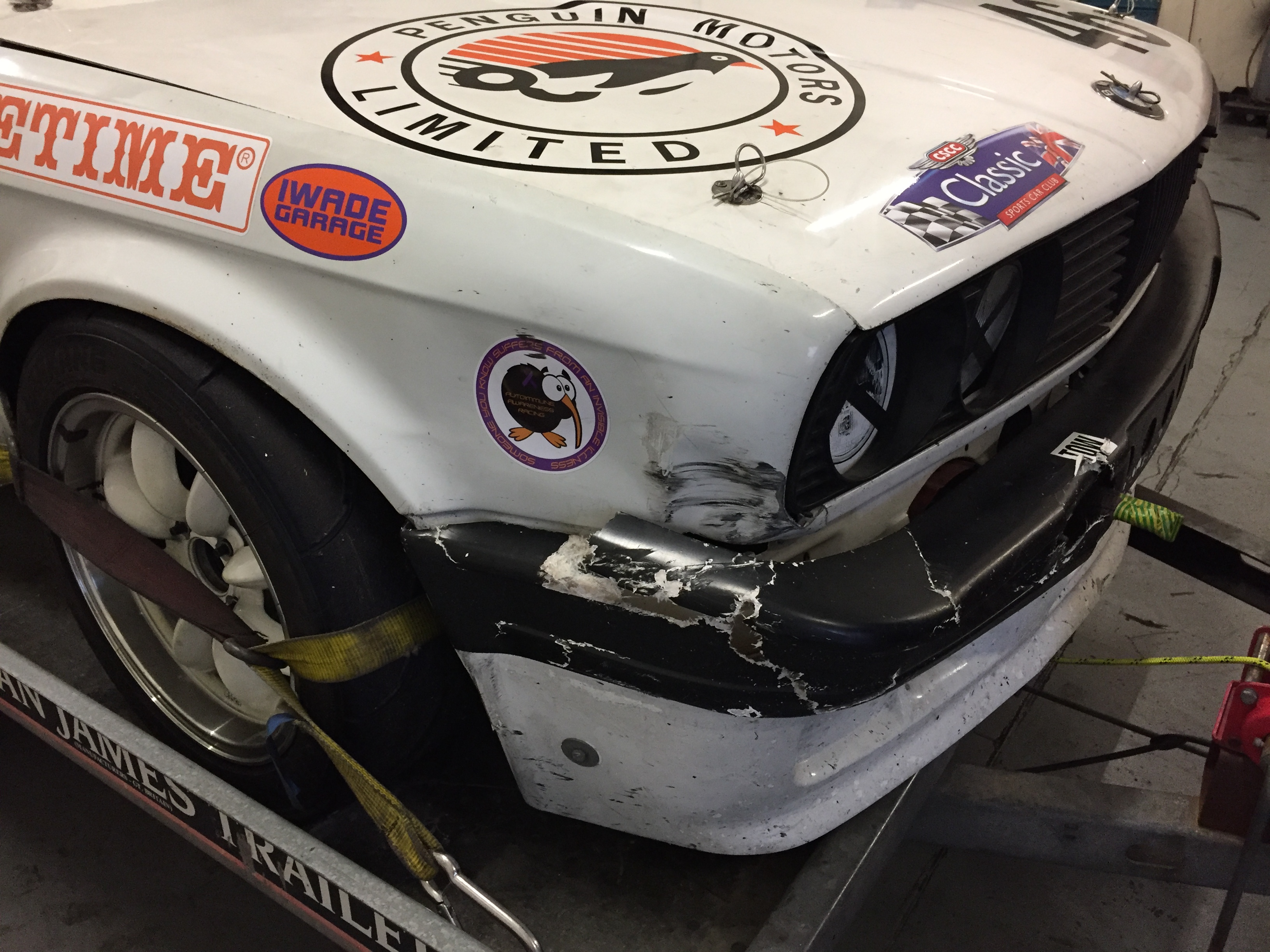

                    could of been worse, the initial hit was pretty hard, i didnt actually see the damage until after the race, it looks better than i expected!
                      #2110

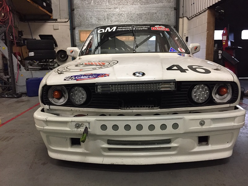

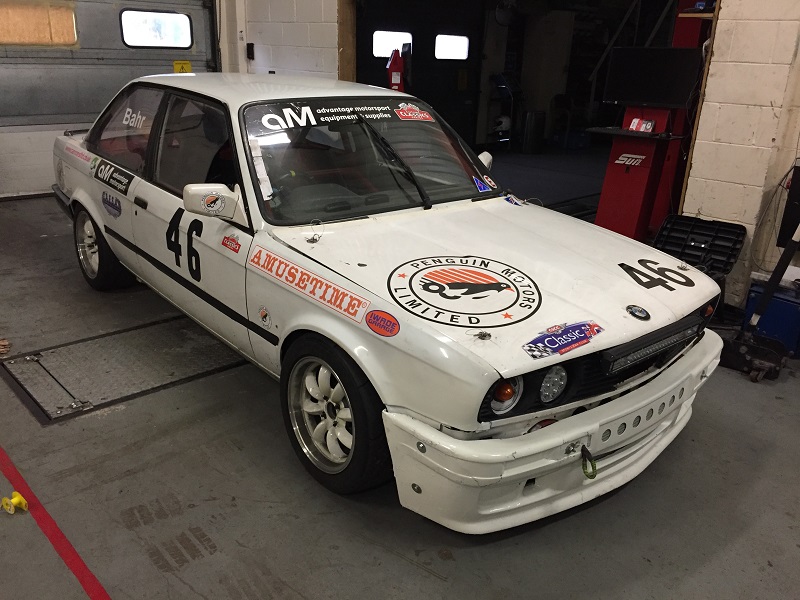

                      fortunately when it came to the dents a bit of work with the porta power got 95% of the out, so just a bit of hammer and dolly work followed by a thin skim of filler got the sheet metal looking close to the correct shape.
                      plenty of super glue and some grp got the front spoiler or or less back to the correct shape, with one one event left this year i wasnt about to buy a new one.
                      you will of noticed the not very subtle lightbar and the cars now sporting front indicators, reason being i had entered a night race, for which the SR's required indicators and the light bar was in a vein hope i would be able to see where i was going in my first ever night race
