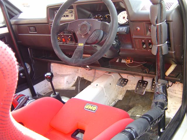

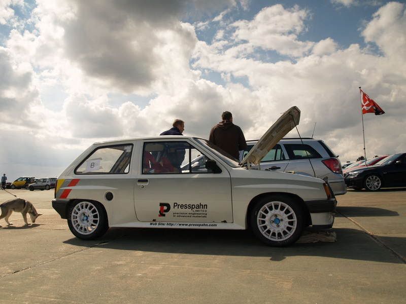

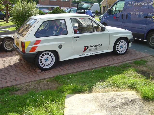

    i got fed up waiting to finish the escort so thought i would treat myself ,i saw this it has competed in hill climbs for the last 15 years. It is only 1300cc but has quaife straight cut ,lsd gearbox coilovers grooved discs and uprated calipers came third in class at harewood hill in march ,the previous owners first outing,now i just need tofind out what liciences etc i need and find a local ish venue to go and have a play any advice as to classes etc much appreciated

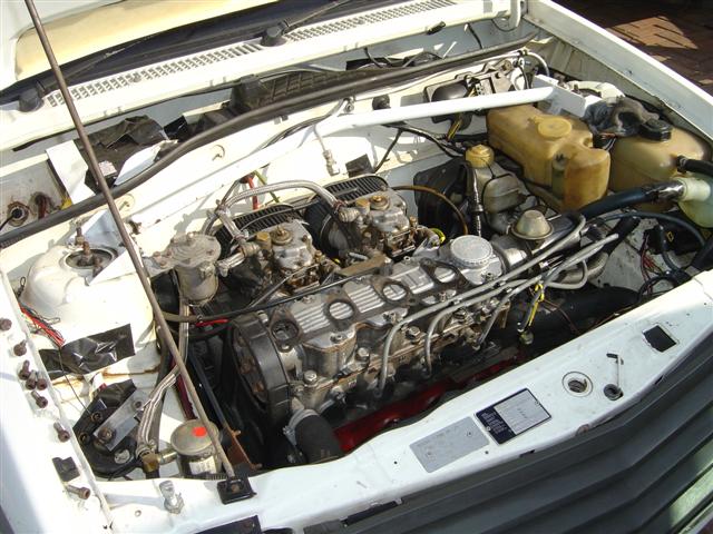

                  Thanks for that Gary it is a tony law 4 into 1 but someone has welded the primaries into the collector and has cracked the collector the metal is pretty thin ,but i think i have managed to bodge it up temporaraly i welded a new part onto it and i think that has stopped it blowing but i have now noticed the rad is leaking so i will have to get a new one and there is an oil leak looks like its coming from the head gasket
                    Re: my new nova
                    They usually leak from the dizzy or cam seals but rarely the head gasket itself
                      Re: my new nova
                      I will look a bit closer when i get a chance but at first glance it looks like the head gasket just under no3 plug
                        Re: my new nova
                        Well it was on gaz mk1s m8s dyno yesterday it made 113 bhp 96lb ft need to get some new idle jets for it other than that everything is fine,he seemed quite impressed for a 1300 just need to sort a new clutch then it should be ready for a few events

                            Hello forktruck not used it in competition yet the head gasket has just gone the head needed skimming luckily for me a chap down the road builds these engines for oval cars he has skimmed the head ,indexed the valves changed the valve springs as the over the nose pressure was very low and he has re-timed the cam as it was set for far to much duration on the inlet ,it has a kent ast 18 cam which should make power all the way to 8100 but it was dropping off at about 6800 before according to the r/r so he has set it for a different duration but i havent had a chance to try it in anger yet but it does feel as though it starts to really come alive at
