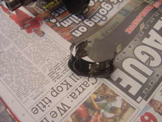

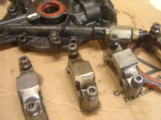

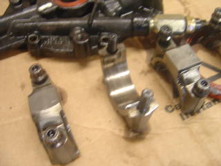

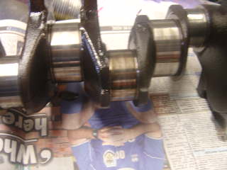

                Well i am no mechanic but i dont think this should look like this
                I will have to speak to Andy to see if its worth rebuilding as we are allready building a 1600 so if its going to be lots of greif and exspense then i will not bother

                  Ouch, looks like its got a little hot

                    unless you have a minimum of a well baffled sump you probably killed it with oil surge,
                    its not for nothing that myself andy pipe and dave all run dry sumps
                      I agree. Well baffled sump is a must. I ran my pinto with baffled sump for years with no problems. Since this Zetec SE has no keys or keyways in the main or big end bearings I chose the dry sump lubrication too.
