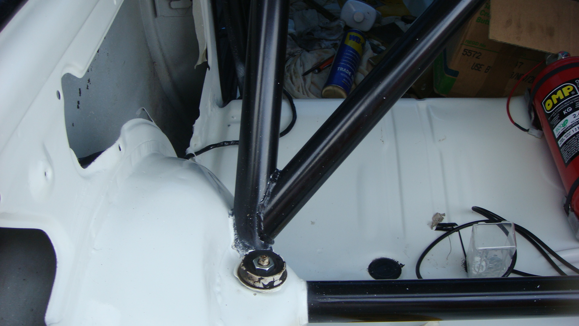

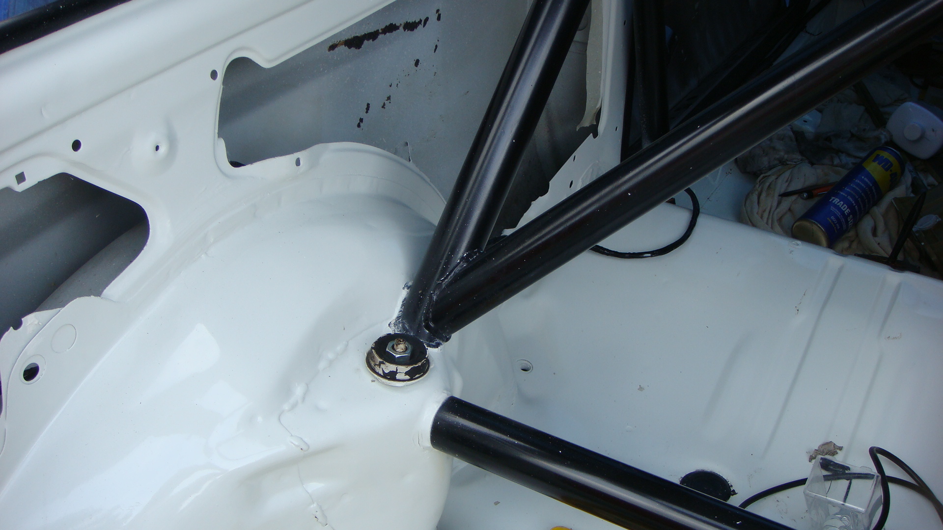

                                Well i have been busy with my new shell and have changed my mind with the car a bit ,rather than a trackday toy i am hoping to go racing in the DMN next year,i started by having the cage welded to the rear wheel arches,then after talking to Andy who does my engine and used to rallycross novas and helps a few hotrod boys he convinced me to run 10 inch wide wheels he even offered to lend me his to try ,i didnt take much convincing,we also decide to go wide track ,i am going in class e against some very quick minis so we are going to need every bit of help we can get.
                                So off to Garys we went to have the rear tubbed and the cage welded to the front turretts,it was also decided it would be a good idea to change the strut tops for some of Garys slotted ones ,i am also having some bottom arms fabricated which are longer to give us the wide track and also to give us camber adjustment along with rose jointed tie bars to give caster adjustment
                                So here are a few pics ,i think i am going to have trouble getting a wide arch kit that is wide enough to cover the arches
