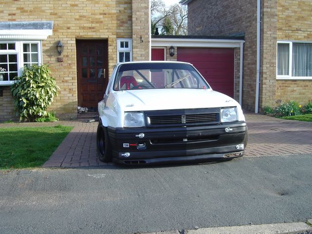

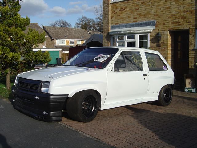

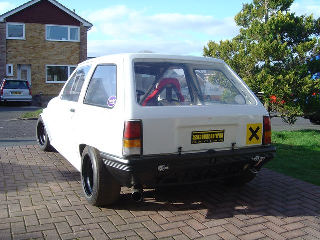

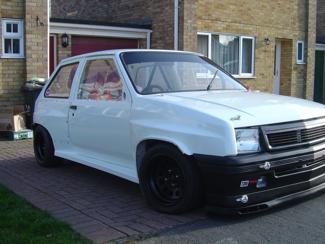

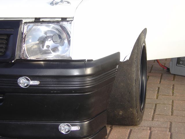

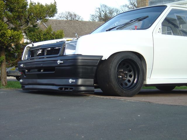

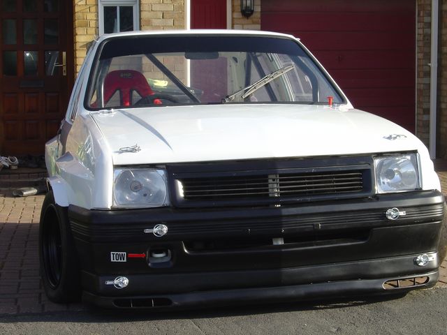

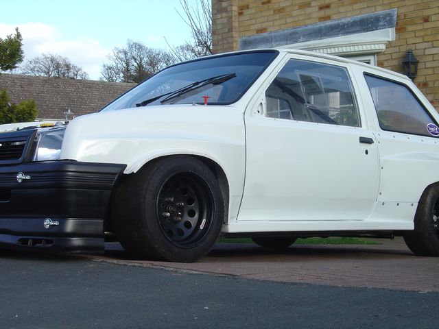

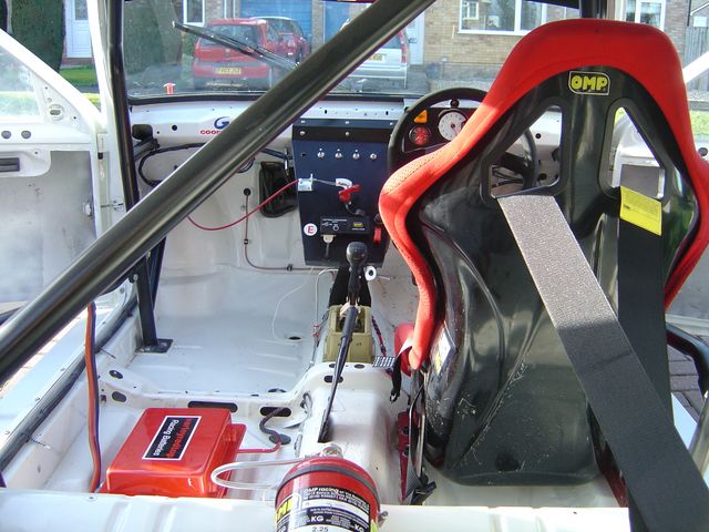

                        Well i think we are about done ,hopefully going to go to a trackday at lydden on saturday,where we rolledthe old nova but i have got to race there so better to bury the demons sooner rather than later still not to sure on the brakes we have disconnected the servo , the pedal is quite hard but it just doesnt seem to want to slow it down not sure if its where they are new brakes and need beding in or if they need to get warm before they will work or if there is a problem ,any suggestions for bedding new discs and pads?
                        Well here are a few pics we got the car out to clean it up more race car than show car
                          #87
                          Re: my new nova
                          Looks excellent What disc/pad combo are you using? Competition material will need bedding in,there are various ways of doing it but I'd be inclined to search the net for manufacturer specific instructions.

                            Re: my new nova
                            looks the nuts bro ,cracking piccies must of got some monkey to lay on the floor to take some of those
                              #89
                              Re: my new nova
                              Looks sweet jezz
                              But how many splitters do you need!! Are you trying to keep it stuck to the ground or something this time?
                                #90
                                Re: my new nova
                                Love it jezz, looks like a proper race car now, very low and mean too
                                The brakes will probably start to make more sense after 2 or 3 laps with a bit of luck. They probably need a bit of bedding in and warming up and as we're used to servos in our road cars its bound to feel a bit alien to start with, but you won't want a servo on track anyways
