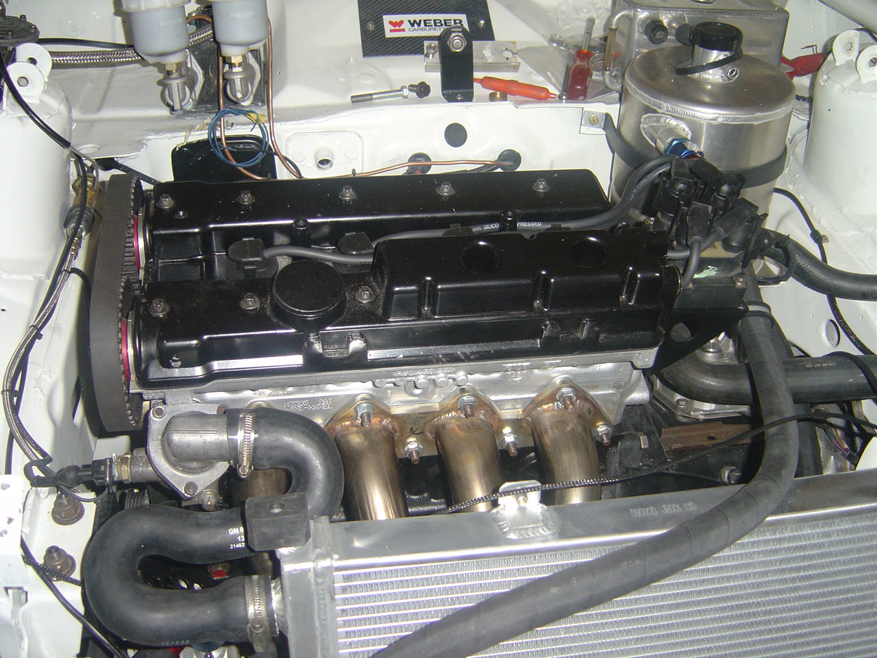

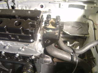

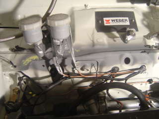

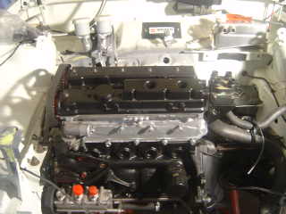

              Well the engine was ready to go in on saturday ,big thanks to Andy for rushing it through as soon as he got the block back,being a tight arse i thought i wouldnt hire an engine crane ,with 3 of us it would be easy to lift in ,1st mistake .With the gearbox bolted up and clutch operation checked it was time to lift it in ,it now weighed a ton but with lots of jiggery pokery and swearing and a few hernia,s later it was all bolted in.

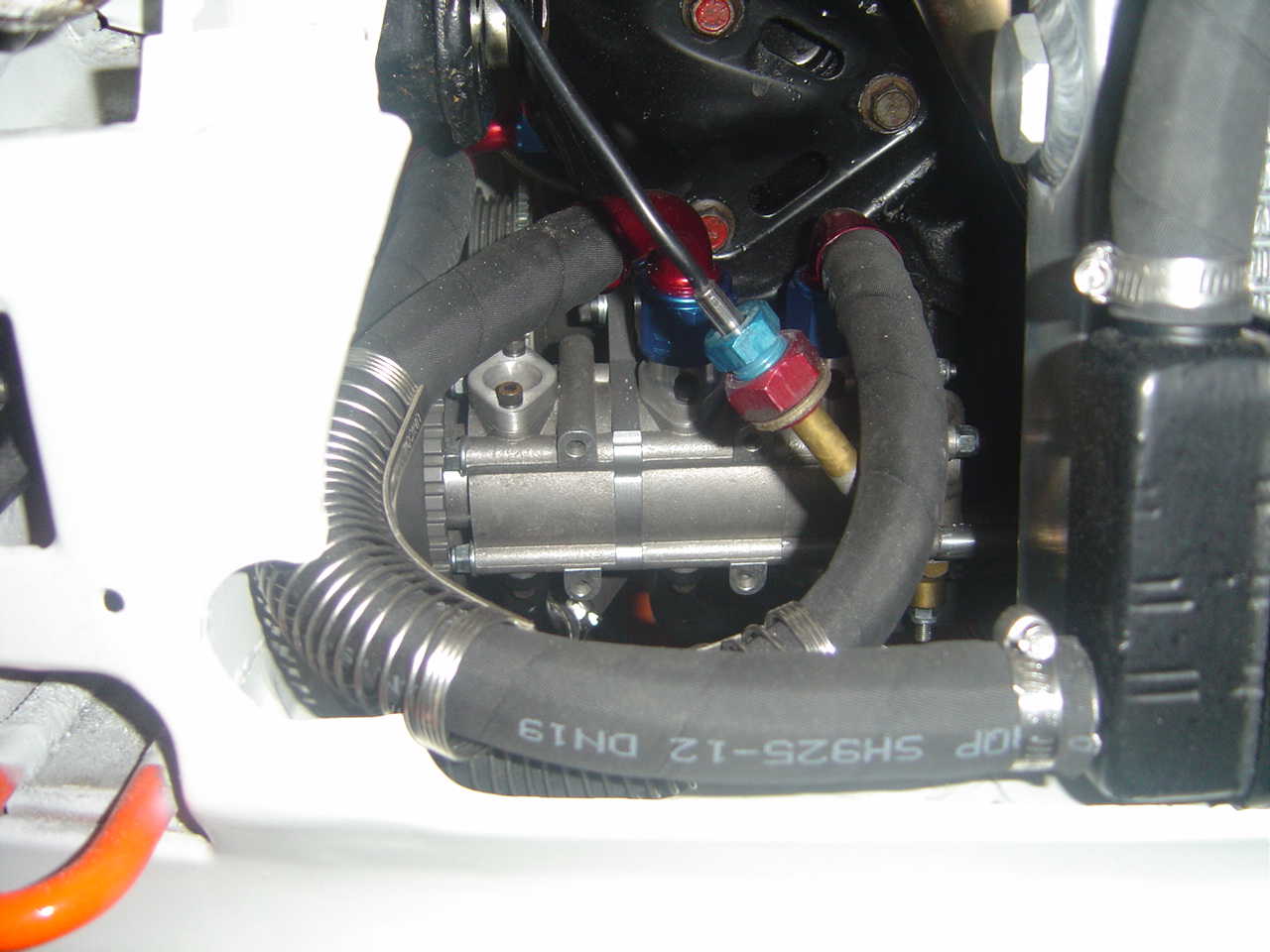

              Time to start bolting the ancillaries on or so i thought,now we hit the problems there is a lip on the bulkhead that has never been a problem with the old engine but with the 16v head the carbs were further back hitting the lip and the brake lines that i had just refilled and bled the night before,so we moved on to the drive shafts ,shouldnt be a problem i thought same gearbox ,forgetting about the new sump yes you guessed it they hit the sump so they need machining to fit.oh well i will start plumbing the dry sump pump ,i had been to think auto and bought fittings and pipethat i guessed i might need ,Andy had said to try to use straight fittings wherever possible so i bought all -10 and -12 straight fittings ,not 1 will fit i need all elbows.

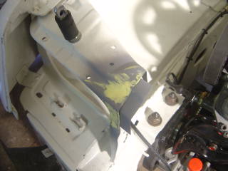

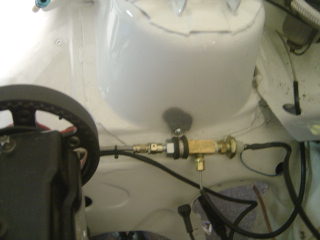

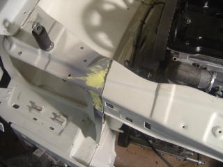

              It was also decided that with the new exhaust manifold being bigger if we ever needed to work around it in a hurry the slam panel would make it difficult so out came the hacksaw and i chopped it out and welded a couple of tags in to sit it on ,i will sort some fixings out later i also plumbed in the oil pressure switch and capilliary gauge to a tapping Andt had done on the front cover
              here are a few pics of where we are to date
              Pics are not the best but you get the idea ,so my nicely painted engine bay is all chopped up ,welded and now covered in primer,it seems to be 1 step forward 3 steps back , i am having the exhaust manifold cam coated which is going to be a couple of weeks so that should give me a chance to sort the little bits out

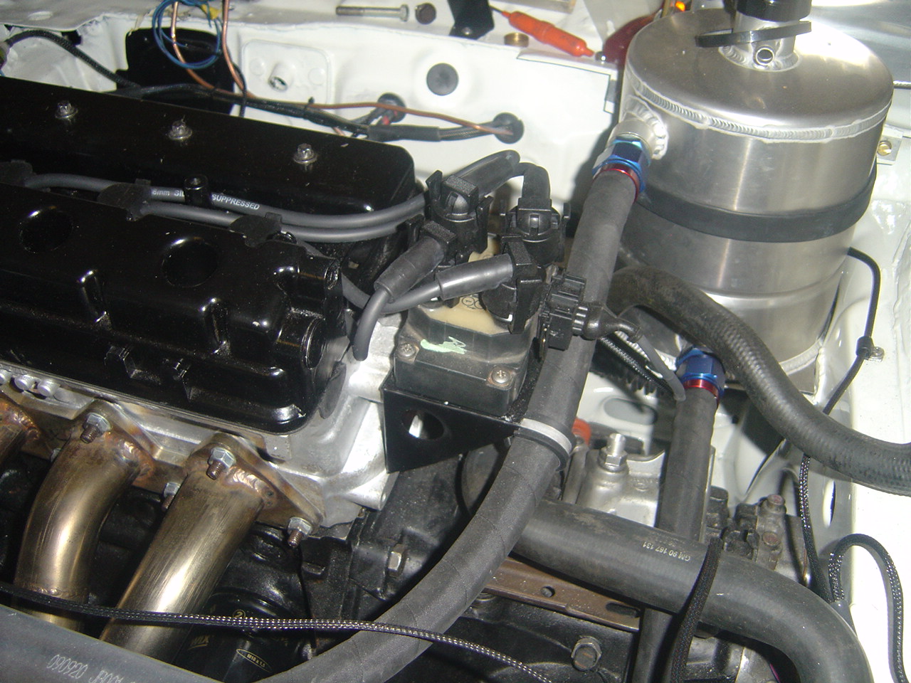

                    No Dmn for me today ,but Andy came round with a few bits to fit ,we changed the chokes on the carbs fitted the driveshafts that Andy had machined ,we then filled the dry sump system and primed it ,fitted the battery pressed the button but no joy
                    Andy then checked the plugs ,no spark so a quick adjust of the c.p.s ,then put the booster pack on pressed the button and away she went
                    We the put some bigger jets in the carbs adjusted the dry sump pump to give a little more pressure so we are almost ready to go.
                    I need to fit a clutch cable and tidy up a few bits then we can go and bed the engine in before a trip to the rollers for a check and adjust if needed then i can go racing again

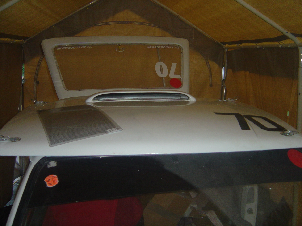

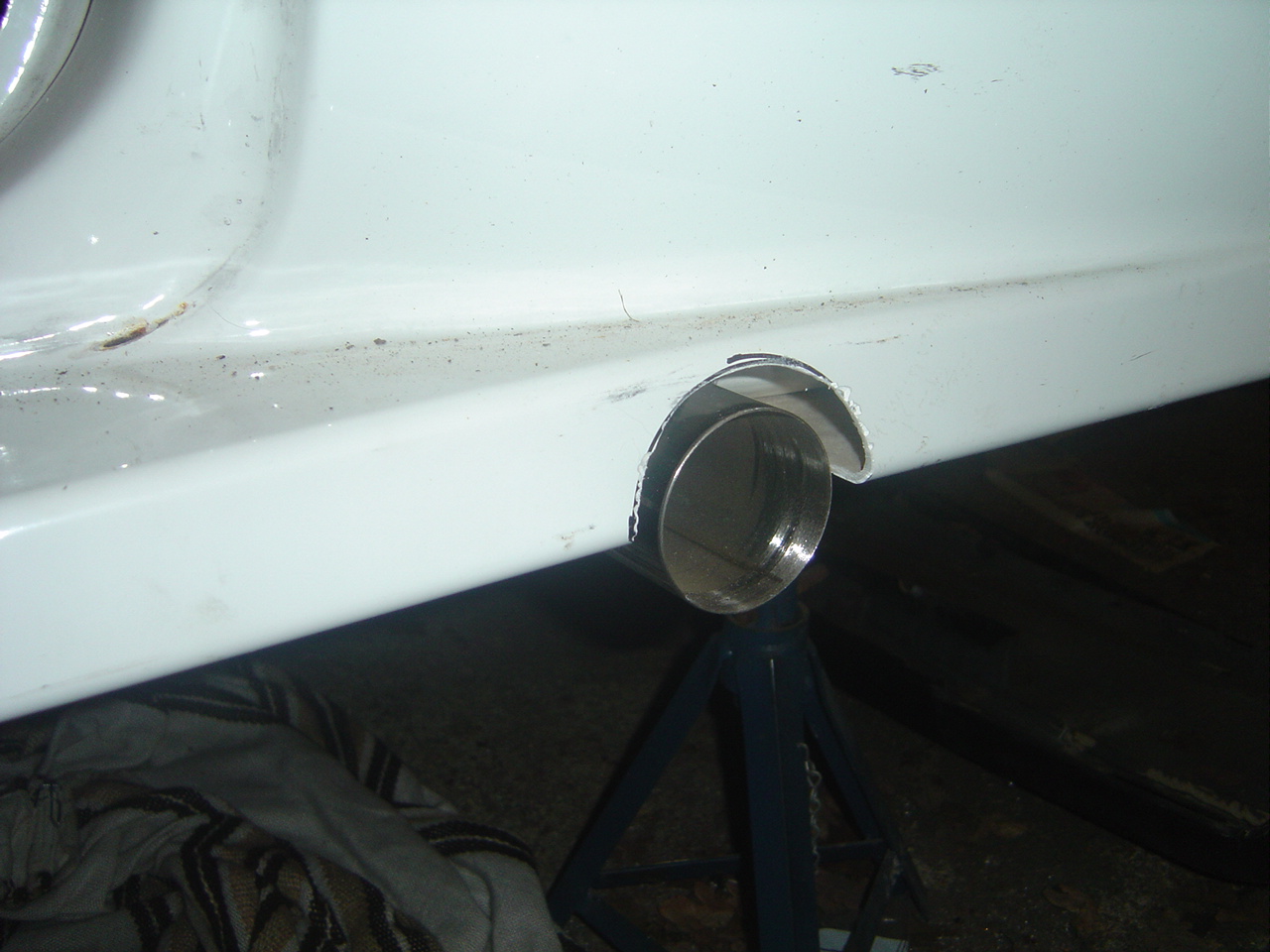

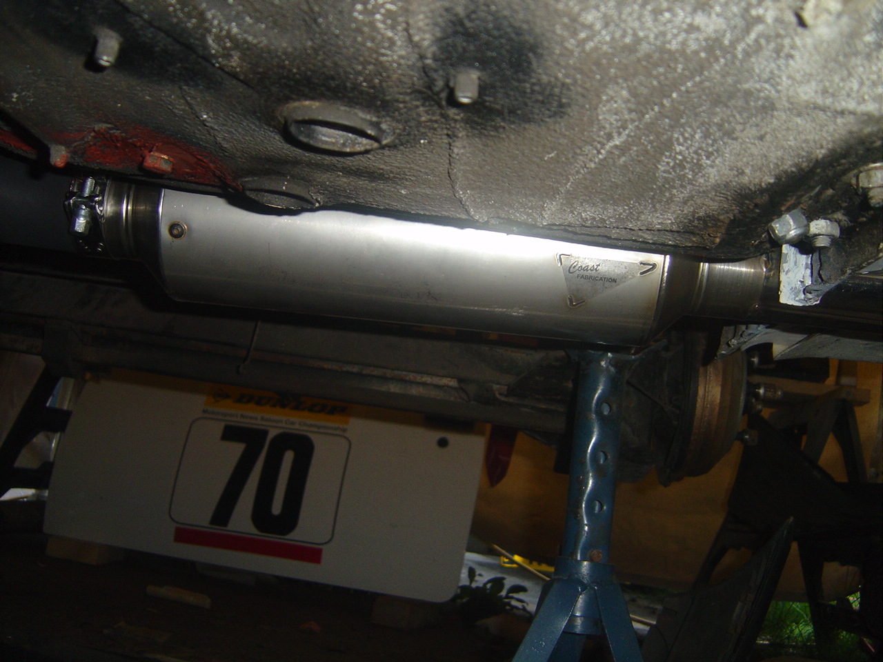

                        Here are a few pics they are a bit on the big side but i cant seem to get the resizer to work on vista
                        there seems to be a bit of a subaru on the bonnet
                        The gazebo i am working in is a bit small ,i must have got a bit disorientated ,because the exhaust ended up coming out of the side
