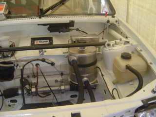

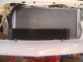

          I have started to put it back together as this is going to rev a bit higher than the old engine it was decided an oil cooler was needed so i got an ebay special setrab cooler at a decent price might be a bit big but we can blank some off if need be i also bought an ally rad as the standard one was going to struggle ,this one has a 40mm core and was cheap at £140.00
          Started to plumb the dry sump system i will finish the rest when the engine is in

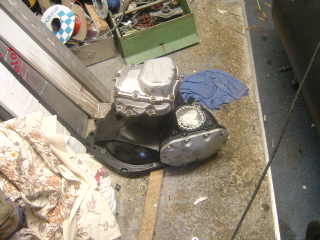

          The gearkit has been built into an f13 casing to suit the new engine Andy found a few issues with the gearkit that he thinks was causing some of the selection issues ,2nd gear was fcuk,d from the last race at Llyden so that was changed.

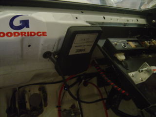

          I have mounted the ecu and wired it i am not sure if its wired right as wiring instructions are hard to come by i think there might be an issue with the fuel pump as it doesnt come on when the ign is switched on ,so i might just put a switch back on it,i have got to put the plugs for the coil t.p.s and c,p.s and that will be the wiring finished again that will wait untill the engine is in so i can get the lengths nice and neat

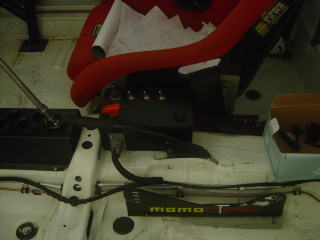

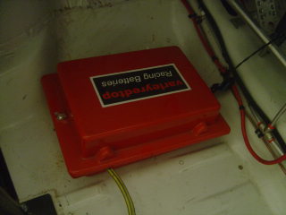

          I have moved the battery to the passenger side footwell as it stopped me from putting a seat in and i want to do a few trackdays in it and get Andy to sit beside me for a bit of tuition and also to see if he has any advice regarding suspension setup
          I have moved the switches to beside the drivers seat as i struggled to reach them before with my harness on so i took a leaf out of Andy and Daves book

                      Nice switch box, interior looking good now. Cant you find the ecu diagrams online. I think MBE aren't so forthcoming with their intructions as DTA though

                        I can get pin locations for the ecu ,but its things like the can high and low are for instance pin 16 and 17 but it doesnt tell you what pins they go to on the other end if that makes sense,
                        as for the engine Andy is waiting for the block to be honed but they have had it for a couple of weeks allready ,they are busy and are doing it as a favour so we will just have to wait,once its back we can crack on as we have everything bar the head gasket which we have got to wait untill its built to work out the thickness required.
