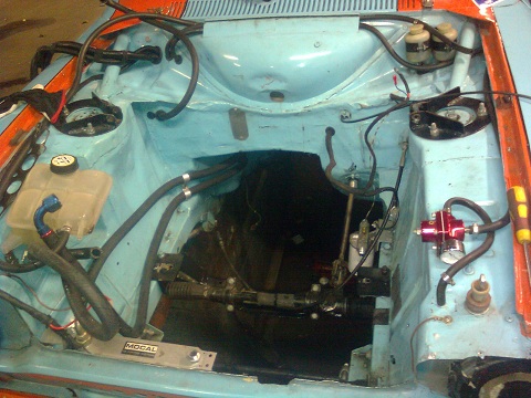

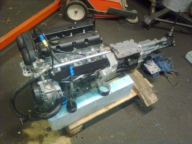

                Had a chance to work on the Escort today. Finally took the engine out for further modifying and a check up.
                I also took a peek at the SL72 since it developed an issue with the reverse gear. It cant hold it keeps jumping off gear. Took the cover out to see what wrong. All looked nice and intact and now the reverse engages beaytifully
                I bet when I put the powertrain back the synptoms are immediately back. Well now I have a good chance to get rid of the oil leaks. Leaks after one race. Factory new box

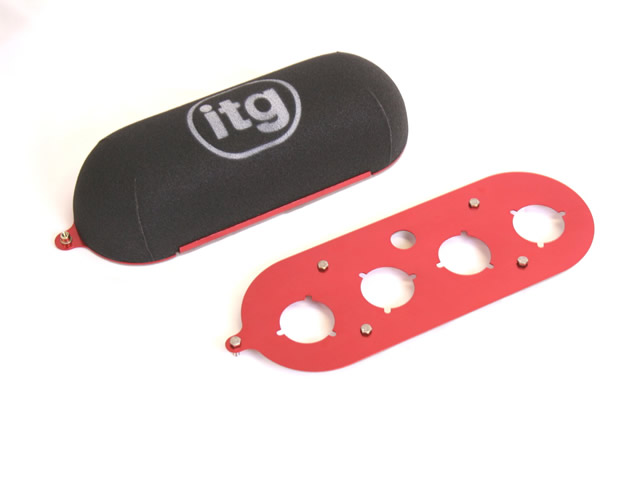

                  I've noticed the ITG filter to look a bit different. Both on the part of locking the bottom part of the filter in place and lacking the metal mesh. Its not visible anyway.
                  With Pico injectors I could usea flat backplate and may just be able to squeese the ITG in place IF it can be creased enough to slide over the trupmets.

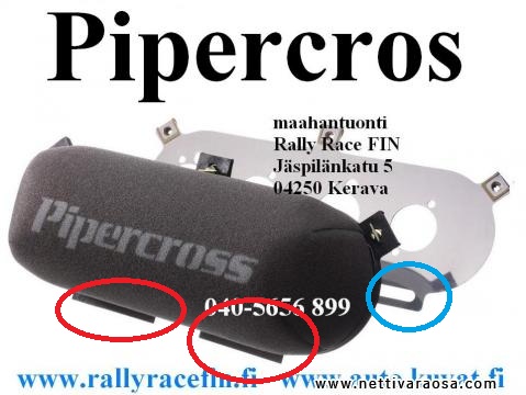

                          I had trouble with the Piper x too. The problem was the bottom part where you need to slide the bottom in place in an angle to get in place. The bottom works as a hinge forcsertain point until you can lift the filter off.
                          The ITG looks different.
                          You need to slide the two flaps (high lighted in red) to these holes(blue) and then lock the top half.
                          ITG seems like you do not need to work it in in an angle so could work better in tight places.
                          No flaps no slots.
